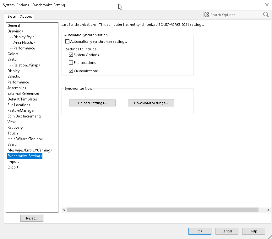

System Options > Synchronize Settings
This dialog is only available in SOLIDWORKS Connected.
Setting
Get/Set Methods
Return value
or
<Value>
or
<OnFlag>
Comment
Last Synchronization
(SOLIDWORKS Connected only)
ISldWorks::GetUserPreferenceStringValue(swUserPreferenceStringValue_e.swLastSynchronizationTimeStamp)
String value
Automatic Synchronization -  Automatically synchronize settings
ISldWorks::GetUserPreferenceToggle(swUserPreferenceToggle_e.swAutomaticSyncSettings) ISldWorks::SetUserPreferenceToggle(swUserPreferenceToggle_e.swAutomaticSyncSettings, <OnFlag>)
Boolean value
When set to true, specified settings to include are automatically synchronized when logging in and out of SOLIDWORKS Connected
Automatic Synchronization - Settings to include - System Options
ISldWorks::GetUserPreferenceToggle(swUserPreferenceToggle_e.swAutoSyncSettingsToInclude_SystemOptions) ISldWorks::SetUserPreferenceToggle(swUserPreferenceToggle_e.swAutoSyncSettingsToInclude_SystemOptions, <OnFlag>)
Boolean value
Valid only if swUserPreferenceToggle_e.swAutomaticSyncSettings is set to true
Automatic Synchronization - Settings to include - File Locations
ISldWorks::GetUserPreferenceToggle(swUserPreferenceToggle_e.swAutoSyncSettingsToInclude_FileLocations) ISldWorks::SetUserPreferenceToggle(swUserPreferenceToggle_e.swAutoSyncSettingsToInclude_FileLocations, <OnFlag>)
Boolean value
Automatic Synchronization - Settings to include - Customizations
ISldWorks::GetUserPreferenceToggle(swUserPreferenceToggle_e.swAutoSyncSettingsToInclude_Customizations) ISldWorks::SetUserPreferenceToggle(swUserPreferenceToggle_e.swAutoSyncSettingsToInclude_Customizations, <OnFlag>)
Boolean value
Synchronize Now - Upload Settings...
ISldWorks::UploadToMySolidWorksSettings
Integer value
Synchronize Now - Download Settings...
ISldWorks::DownloadFromMySolidWorksSettings
Integer value
