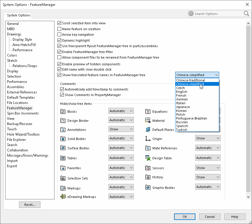

System Options > FeatureManager
Setting
Get/Set Methods
Return Value
or
<Value>
or
<OnFlag>
Comment
Scroll selected item into view
ISldWorks::GetUserPreferenceToggle(swUserPreferenceToggle_e.swFeatureManagerEnsureVisible)
ISldWorks::SetUserPreferenceToggle(swUserPreferenceToggle_e.swFeatureManagerEnsureVisible, <OnFlag>)
Boolean value
Specifies whether FeatureManager design tree should automatically scroll to display feature icon related to selected items in graphics area
Name feature on creation
ISldWorks::GetUserPreferenceToggle(swUserPreferenceToggle_e.swFeatureManagerNameFeatureWhenCreated)
ISldWorks::SetUserPreferenceToggle(swUserPreferenceToggle_e.swFeatureManagerNameFeatureWhenCreated, <OnFlag>)
Boolean value
Specifies to automatically select new feature in FeatureManager design tree to name it
Arrow key navigation
ISldWorks::GetUserPreferenceToggle(swUserPreferenceToggle_e.swFeatureManagerKeyboardNavigation)
ISldWorks::SetUserPreferenceToggle(swUserPreferenceToggle_e.swFeatureManagerKeyboardNavigation, <OnFlag>)
Boolean value
Specifies whether arrow keys can be used to traverse FeatureManager design tree, and expand or collapse design tree and its contents
Dynamic highlight
ISldWorks::GetUserPreferenceToggle(swUserPreferenceToggle_e.swFeatureManagerDynamicHighlight)
ISldWorks::SetUserPreferenceToggle(swUserPreferenceToggle_e.swFeatureManagerDynamicHighlight, <OnFlag>)
Boolean value
Specifies whether geometry in graphics area is highlighted when pointer passes over item in FeatureManager design tree
Use transparent flyout FeatureManager tree in parts/assemblies
ISldWorks::GetUserPreferenceToggle(swUserPreferenceToggle_e.swFeatureManagerTransparentFlyout)
ISldWorks::SetUserPreferenceToggle(swUserPreferenceToggle_e.swFeatureManagerTransparentFlyout, <OnFlag>)
Boolean value
Specifies whether to use transparent flyout FeatureManager in part and assembly documents
Enable FeatureManager tree filter
ISldWorks::GetUserPreferenceToggle(swUserPreferenceToggle_e.swFeatureManagerEnableTreeFilter)
ISldWorks::SetUserPreferenceToggle(swUserPreferenceToggle_e.swFeatureManagerEnableTreeFilter, <OnFlag>)
Boolean value
Specifies whether to display the FeatureManager design tree filter
Unlike the user interface, you can turn this setting on or off when a model document is open
Allow component files to be renamed from FeatureManager tree
(Not supported in SOLIDWORKS Connected)
ISldWorks::GetUserPreferenceToggle(swUserPreferenceToggle_e.swFeatureManagerEnableRenamingComponent)
ISldWorks::SetUserPreferenceToggle(swUserPreferenceToggle_e.swFeatureManagerEnableRenamingComponent, <OnFlag>)
Boolean value
Specifies whether to enable renaming components
Enable preview of hidden components
ISldWorks::GetUserPreferenceToggle(swUserPreferenceToggle_e.swFeatureManagerEnablePreviewHiddenComponents)
ISldWorks::SetUserPreferenceToggle(swUserPreferenceToggle_e.swFeatureManagerEnablePreviewHiddenComponents, <OnFlag>)
Boolean value
Specifies whether to enable preview of hidden components
Edit name with slow double click
ISldWorks::GetUserPreferenceToggle(swUserPreferenceToggle_e.swEditNameWithSlowDoubleClick)
ISldWorks::SetUserPreferenceToggle(swUserPreferenceToggle_e.swEditNameWithSlowDoubleClick, <OnFlag>)
Boolean value
Show translated feature names in FeatureManager tree
ISldWorks::GetUserPreferenceToggle(swUserPreferenceToggle_e.swFeatureManagerShowTranslatedNameInFMTree)
ISldWorks::SetUserPreferenceToggle(swUserPreferenceToggle_e.swFeatureManagerShowTranslatedNameInFMTree, <OnFlag>)
Boolean value
Language drop-down
ISldWorks::GetUserPreferenceIntegerValue(swUserPreferenceIntegerValue_e.swFeatureManagerTranslatedLanguage)
ISldWorks::SetUserPreferenceIntegerValue(swUserPreferenceIntegerValue_e.swFeatureManagerTranslatedLanguage, swAutoHideShowResponse_e.<Value>)
See swUserPreferencesLanguages_e for valid options
Valid only if swUserPreferenceToggle_e.swFeatureManagerShowTranslatedNameInFMTree is set to true.

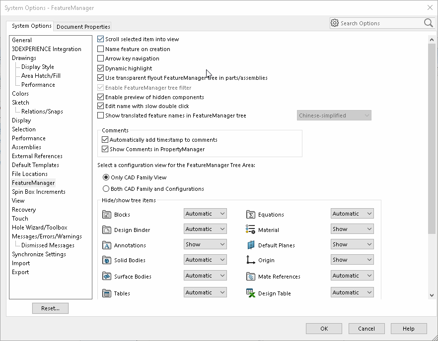

Select a configuration view for the FeatureManager Tree Area - Only CAD Family View or Both CAD Family and Configurations
(SOLIDWORKS Connected only)
ISldWorks::GetUserPreferenceIntegerValue(swUserPreferenceIntegerValue_e.swConfigurationViewForFeatureManagerTree)
ISldWorks::SetUserPreferenceIntegerValue(swUserPreferenceIntegerValue_e.swConfigurationViewForFeatureManagerTree, swFeatureManagerTreeViewCADFamily_e.<Value>)
See swFeatureManagerTreeViewCADFamily_e for valid options
