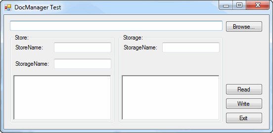

'  8. Substitute your_license_key with your SOLIDWORKS Document
'     Manager license key.
' Postconditions:
'  1. Displays a dialog.
'  2. Click Browse.
'     a. Locate and click a SOLIDWORKS document.
'     b. Click Open.
'  3. Type temp in StoreName and in both StorageName fields.
'  4. Type Some third-party text in both text boxes.
'  5. Click Write.
'  6. Click Exit.
'  7. Press F5.
'  8. In the dialog, click Browse.
'     a. Locate and click the document you clicked in step 2a.
'     b. Click Open.
'  9. Type temp in StoreName and in both StorageName fields.
' 10. Click Read.
' 11. Displays Some third-party text in both text boxes.
' 12. Click Exit.

        Me.rtbStore = New System.Windows.Forms.RichTextBox()
        Me.btnExit = New System.Windows.Forms.Button()
        Me.btnSave = New System.Windows.Forms.Button()
        Me.btnOpen = New System.Windows.Forms.Button()
        Me.btnFile = New System.Windows.Forms.Button()
        Me.OpenFileDialog1 = New System.Windows.Forms.OpenFileDialog()
        Me.txtFileName = New System.Windows.Forms.TextBox()
        Me.groupBox1 = New System.Windows.Forms.GroupBox()
        Me.txtStoreName = New System.Windows.Forms.TextBox()
        Me.label1 = New System.Windows.Forms.Label()
        Me.label3 = New System.Windows.Forms.Label()
        Me.txtStreamName = New System.Windows.Forms.TextBox()
        Me.groupBox2 = New System.Windows.Forms.GroupBox()
        Me.label5 = New System.Windows.Forms.Label()
        Me.txtStorageName = New System.Windows.Forms.TextBox()
        Me.groupBox1.SuspendLayout()
        Me.groupBox2.SuspendLayout()
        Me.SuspendLayout()
        ' rtbStorage
        Me.rtbStorage.Location = New System.Drawing.Point(6, 83)
        Me.rtbStorage.Name = "rtbStorage"
        Me.rtbStorage.Size = New System.Drawing.Size(198, 91)
        Me.rtbStorage.TabIndex = 15
        Me.rtbStorage.Text = ""
        ' rtbStore
        Me.rtbStore.Location = New System.Drawing.Point(6, 83)
        Me.rtbStore.Name = "rtbStore"
        Me.rtbStore.Size = New System.Drawing.Size(198, 91)
        Me.rtbStore.TabIndex = 14
        Me.rtbStore.Text = ""
        ' btnExit
        Me.btnExit.Location = New System.Drawing.Point(448, 197)
        Me.btnExit.Name = "btnExit"
        Me.btnExit.Size = New System.Drawing.Size(75, 23)
        Me.btnExit.TabIndex = 13
        Me.btnExit.Text = "Exit"
        Me.btnExit.UseVisualStyleBackColor = True
        'Me.btnExit.Click += New System.EventHandler(Me.btnExit_Click)
        ' btnSave
        Me.btnSave.Location = New System.Drawing.Point(448, 168)
        Me.btnSave.Name = "btnSave"
        Me.btnSave.Size = New System.Drawing.Size(75, 23)
        Me.btnSave.TabIndex = 12
        Me.btnSave.Text = "Write"
        Me.btnSave.UseVisualStyleBackColor = True
        'Me.btnSave.Click += New System.EventHandler(Me.btnSave_Click)
        ' btnOpen
        Me.btnOpen.Location = New System.Drawing.Point(448, 139)
        Me.btnOpen.Name = "btnOpen"
        Me.btnOpen.Size = New System.Drawing.Size(75, 23)
        Me.btnOpen.TabIndex = 11
        Me.btnOpen.Text = "Read"
        Me.btnOpen.UseVisualStyleBackColor = True
        'Me.btnOpen.Click += New System.EventHandler(Me.btnOpen_Click)
        ' btnFile
        Me.btnFile.Location = New System.Drawing.Point(448, 12)
        Me.btnFile.Name = "btnFile"
        Me.btnFile.Size = New System.Drawing.Size(75, 23)
        Me.btnFile.TabIndex = 10
        Me.btnFile.Text = "Browse..."
        Me.btnFile.UseVisualStyleBackColor = True
        'Me.btnFile.Click += New System.EventHandler(Me.btnFile_Click)
        ' OpenFileDialog1
        Me.OpenFileDialog1.FileName = "OpenFileDialog1"
        ' txtFileName
        Me.txtFileName.Location = New System.Drawing.Point(12, 12)
        Me.txtFileName.Name = "txtFileName"
        Me.txtFileName.Size = New System.Drawing.Size(430, 20)
        Me.txtFileName.TabIndex = 9
        ' groupBox1
        Me.groupBox1.Controls.Add(Me.label3)
        Me.groupBox1.Controls.Add(Me.txtStreamName)
        Me.groupBox1.Controls.Add(Me.label1)
        Me.groupBox1.Controls.Add(Me.txtStoreName)
        Me.groupBox1.Controls.Add(Me.rtbStore)
        Me.groupBox1.Location = New System.Drawing.Point(13, 39)
        Me.groupBox1.Name = "groupBox1"
        Me.groupBox1.Size = New System.Drawing.Size(210, 180)
        Me.groupBox1.TabIndex = 18
        Me.groupBox1.TabStop = False
        Me.groupBox1.Text = "Store:"
        ' txtStoreName
        Me.txtStoreName.Location = New System.Drawing.Point(88, 17)
        Me.txtStoreName.Name = "txtStoreName"
        Me.txtStoreName.Size = New System.Drawing.Size(116, 20)
        Me.txtStoreName.TabIndex = 15
        ' label1
        Me.label1.AutoSize = True
        Me.label1.Location = New System.Drawing.Point(7, 20)
        Me.label1.Name = "label1"
        Me.label1.Size = New System.Drawing.Size(63, 13)
        Me.label1.TabIndex = 16
        Me.label1.Text = "StoreName:"
        ' label3
        Me.label3.AutoSize = True
        Me.label3.Location = New System.Drawing.Point(7, 53)
        Me.label3.Name = "label3"
        Me.label3.Size = New System.Drawing.Size(75, 13)
        Me.label3.TabIndex = 18
        Me.label3.Text = "StorageName:"
        ' txtStreamName
        Me.txtStreamName.Location = New System.Drawing.Point(88, 50)
        Me.txtStreamName.Name = "txtStreamName"
        Me.txtStreamName.Size = New System.Drawing.Size(116, 20)
        Me.txtStreamName.TabIndex = 17
        ' groupBox2
        Me.groupBox2.Controls.Add(Me.rtbStorage)
        Me.groupBox2.Controls.Add(Me.label5)
        Me.groupBox2.Controls.Add(Me.txtStorageName)
        Me.groupBox2.Location = New System.Drawing.Point(232, 39)
        Me.groupBox2.Name = "groupBox2"
        Me.groupBox2.Size = New System.Drawing.Size(210, 180)
        Me.groupBox2.TabIndex = 19
        Me.groupBox2.TabStop = False
        Me.groupBox2.Text = "Storage:"
        ' label5
        Me.label5.AutoSize = True
        Me.label5.Location = New System.Drawing.Point(7, 20)
        Me.label5.Name = "label5"
        Me.label5.Size = New System.Drawing.Size(75, 13)
        Me.label5.TabIndex = 16
        Me.label5.Text = "StorageName:"
        ' txtStorageName
        Me.txtStorageName.Location = New System.Drawing.Point(88, 17)
        Me.txtStorageName.Name = "txtStorageName"
        Me.txtStorageName.Size = New System.Drawing.Size(116, 20)
        Me.txtStorageName.TabIndex = 15
        ' Form1
        Me.AutoScaleDimensions = New System.Drawing.SizeF(6.0F, 13.0F)
        Me.AutoScaleMode = System.Windows.Forms.AutoScaleMode.Font
        Me.ClientSize = New System.Drawing.Size(536, 231)
        Me.Controls.Add(Me.btnExit)
        Me.Controls.Add(Me.btnSave)
        Me.Controls.Add(Me.btnOpen)
        Me.Controls.Add(Me.btnFile)
        Me.Controls.Add(Me.txtFileName)
        Me.Controls.Add(Me.groupBox1)
        Me.Controls.Add(Me.groupBox2)
        Me.MaximumSize = New System.Drawing.Size(552, 269)
        Me.MinimumSize = New System.Drawing.Size(552, 269)
        Me.Name = "Form1"
        Me.Text = "DocManager Test"
        Me.groupBox1.ResumeLayout(False)
        Me.groupBox1.PerformLayout()
        Me.groupBox2.ResumeLayout(False)
        Me.groupBox2.PerformLayout()
        Me.ResumeLayout(False)
        Me.PerformLayout()
    End Sub
    Friend WithEvents rtbStorage As System.Windows.Forms.RichTextBox
    Friend WithEvents rtbStore As System.Windows.Forms.RichTextBox
    Friend WithEvents btnExit As System.Windows.Forms.Button
    Friend WithEvents btnSave As System.Windows.Forms.Button
    Friend WithEvents btnOpen As System.Windows.Forms.Button
    Friend WithEvents btnFile As System.Windows.Forms.Button
    Friend WithEvents OpenFileDialog1 As System.Windows.Forms.OpenFileDialog
    Friend WithEvents txtFileName As System.Windows.Forms.TextBox
    Private groupBox1 As System.Windows.Forms.GroupBox
    Private label3 As System.Windows.Forms.Label
    Private txtStreamName As System.Windows.Forms.TextBox
    Private label1 As System.Windows.Forms.Label
    Private txtStoreName As System.Windows.Forms.TextBox
    Private groupBox2 As System.Windows.Forms.GroupBox
    Private label5 As System.Windows.Forms.Label
    Private txtStorageName As System.Windows.Forms.TextBox
End Class
