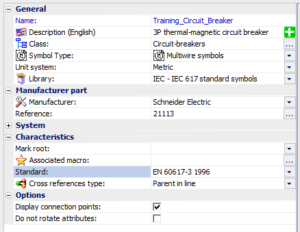

5. Enter the properties as shown below.
6. Click on the OK
button to create the symbol.

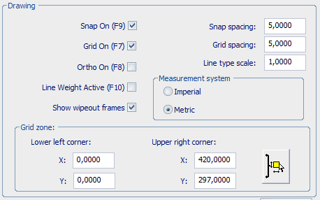

Next, set the snap spacing so the connection points are
placed at the same intervals as the distance between the wires
(5mm by default). |
10. Right-click in the lock bar (the bottom right
of the screen) to open the drawing support dialog box.
11. Set the snap and grid settings as shown opposite.
12. Then delete the rectangle.

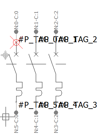

15. Add 3 disconnectable Circuit
breaker/Switch type circuits.
Menu: Edit symbol >
New circuit |
16. To insert the connection points, select circuit
0 and click on the Connection point
icon in the Edit symbol menu.
Menu: Edit symbol >
Connection point |
The connection point block is attached to the cursor. It
is composed of a line and two circles. |
17. Press [Space]
to rotate the connection point.
18. Insert the connection point so that the white
circle coincides with the point the wire will connect to.
19. Insert the five other connection points, selecting
the corresponding circuits beforehand.
The dockable panel displays the properties of the connection
points, allowing any allocation errors to be corrected.
In each circuit, the number of the point in the upper part must
be less than the one in the lower part. |
20. To insert the attributes, click on the Attribute
insertion icon in the Edit symbol
menu.
Menu: Edit symbol >
Insert attribute |
21. In the Attributes management dialog box, check
the boxes for the attributes to be inserted on the symbols.
Identification
/ #TAG
Descriptive data
/ Cross references / #CROSS_REF
Descriptive data
/ Manufacturer data / #TD_1
Descriptive
data / Manufacturer data / #TD_4 |
22. Insert the attributes near the symbol.
The Properties command
of the attribute allows you to modify its font, height, and justification. |
