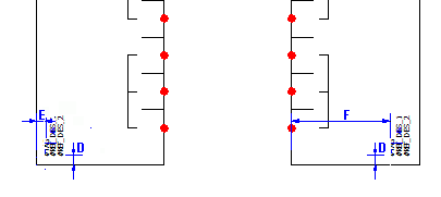

Information (Top)
Y
coordinate: Enter the distance between
the horizontal line of the module and the insertion point of attributes.
These attributes have a right justification (A).
X for left
symbol: Enter the distance between the vertical line of the module
and the insertion point of attributes for a module symbol inserted on
the left of the drawing (B).
X for right
the right of the drawing (C).
Information (Bottom)
Y coordinate: Enter the distance
between the horizontal line of the module and the insertion point of attributes.
These attributes have a left justification (D).
X for left symbol: Enter the
distance between the vertical line of the module and the insertion point
of attributes for a module symbol inserted on the left of the drawing
(E).
X for right symbol: Enter the
of attributes for a module symbol inserted on the right of the drawing
(F).
