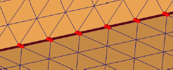

Selecting option A -> B moves green
node A to the position of red node B. Connectivity
of neighboring elements adapts to the new position
of node A. Nodes A and B are merged. |
