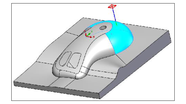

Support for Nonplanar Surfaces for Z Axis Probing
You can select nonplanar surfaces in the direction of the Z axis for probe cycles.
The Z Probe Cycle is available in the Probe tab of the Operation Parameters dialog box. The default touch off point for toolpath generation is the top-most point of the selected face in the Z direction.
