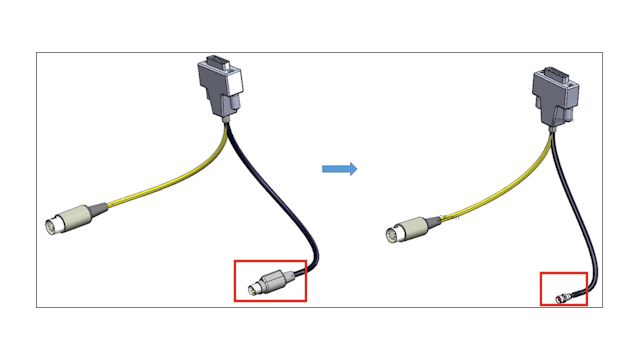

In a routing assembly, when you replace a connector in a
From/To list, you can keep the original
connections and the electrical data.
In the Import
Electrical Data PropertyManager, select Replace component to replace the existing connector by the new one in
the From/To list. Select Delete existing segment and create new guidelines if the
new connector does not have the same connections.
Select Update data
to add new data or to change the data of an existing component without resetting any
unchanged components.
