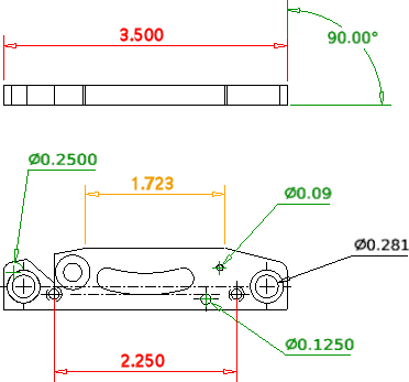

    Option Automated Revision Results Manual Revision Results
    Number extracted annotations have been deleted from the file Lists the number of extracted annotations that were removed from the revised file. Under Remove all deleted characteristics from project and, select one of the following:
    • Retire removed characteristic number(s). Removes corresponding balloons as if you deleted them with Renumber remaining characteristics cleared.
    • Reuse removed characteristic number(s). Removes corresponding balloons as if you deleted them with Renumber remaining characteristics selected.
    In the Table Manager, on the Characteristics tab, deleted characteristics appear in red. Right-click the characteristics to delete and click Delete > Delete Inspection Characteristic. This deletes the characteristic and renumbers the remaining characteristics. If you do not delete the characteristics, they remain highlighted in red.
    Number extracted annotations values have been modified in the file Lists the number of extracted annotations that were modified in the revised file. You can:
    • Update existing characteristic(s) with new values. Updates the values of the original characteristics using the established balloon and characteristic numbers from the revised file.
    • Do not update existing characteristic(s) with new values. Makes no changes to the characteristics. This may cause a discrepancy between the values in the file and the values on the Characteristic tab in the Table Manager.
    Lists the number of extracted annotations that have changed in the revised file.
    In the Table Manager, on the Characteristics tab, deleted characteristics appear in yellow. Right-click the characteristics to update and click Update Characteristic Value. If you do not update the values, they remain highlighted in yellow.
    Number new annotations have been found in the file Lists the number of characteristics in the file that were not extracted in the previously saved state of the project (even in the characteristic was present in the previous revision). You can:
    • Automatically extract new annotations. Extracts and balloons all new characteristics (does not change established numbering).
    • Do not extract new annotations. Does not extract the new characteristics. The characteristics appear as unextracted (gray) when automated revision processing finishes.
    Lists the number of extracted annotations that were added in the revised file.
    In the Table Manager, on the Characteristics tab, new characteristics appear in green. Right-click the characteristics to add and click Add Characteristic with Number > Balloon number
