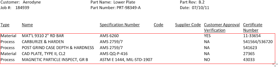

You
can extract data from the drawing to fill in the Specifications tab in the Table Manager.
To extract specification data:
In the Table Manager, on the Specifications tab, click Extract
text from PDF in viewer area
In the graphics area, box-select the specifications, excluding
the headers.
In the Properties/Preferences PropertyManager, the data appears in the
Property Table Extraction
tab.
In the Properties/Preferences PropertyManager, on the Property Table Extraction tab:
Right-click each column header to map the data to the
correct field.
Edit the data if required.
Click
The data appears in the Specifications tab.
