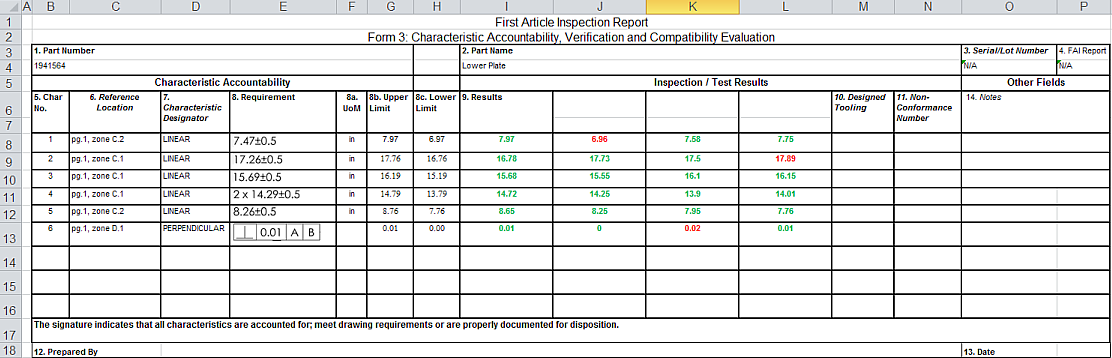

    Example of a report with values populated from an SOLIDWORKS Inspection project:
