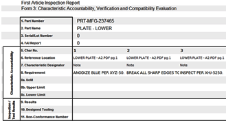

Vertical Based Template / Horizontal Based Template |
Displays tokens vertically or
horizontally in report templates. Select the orientation before
inserting tokens in a report. For example, if you
select Horizontal Based
Template and set Characteristic Token to Balloon Number, each column
displays a Balloon Number
(1,2,3,...). If you select Vertical
Based Template, Balloon Number displays in rows instead of
columns.
Horizontal Based Template:
Vertical
Based Template:
