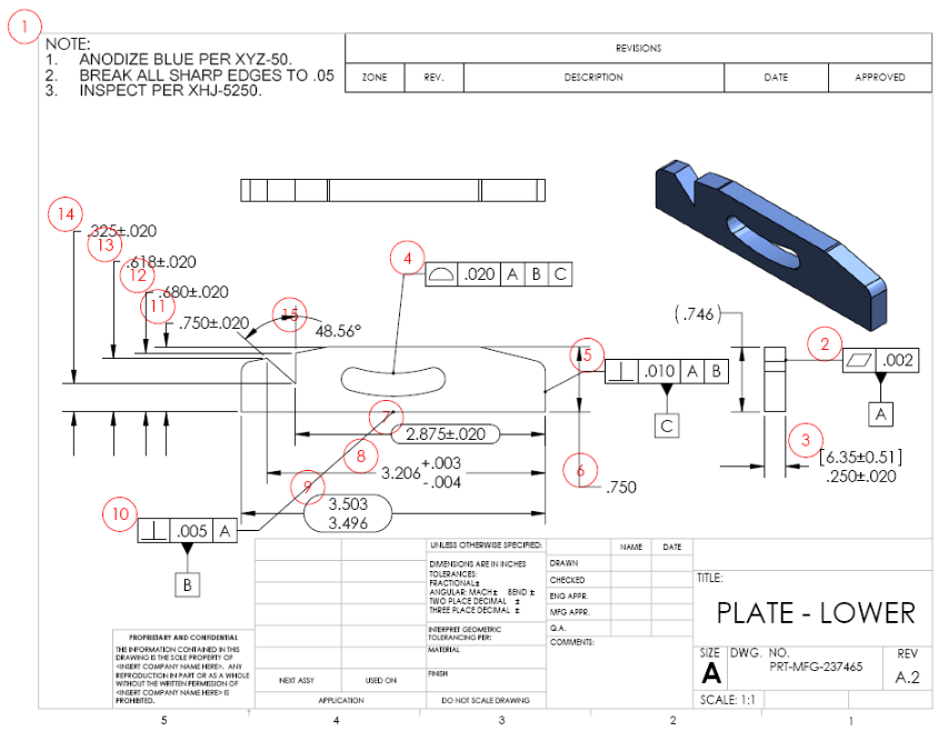

After you balloon the inspection characteristics, you can export the
ballooned document to a 2D PDF.
Click Export to 2D PDF
(SOLIDWORKS Inspection
toolbar).
