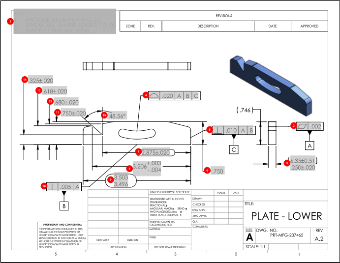

After you balloon the inspection characteristics, you can export the inspection project to a SOLIDWORKS Inspection Project file (.ixprj).
You can generate the ballooned drawings and inspection reports quickly in SOLIDWORKS using the SOLIDWORKS Inspection add-in. You can open the inspection project (.ixprj) in the standalone application to enter measurements and import CMM results.
