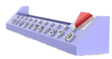

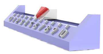

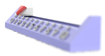

Example of differences in depth of field:
None Near
Middle Far
