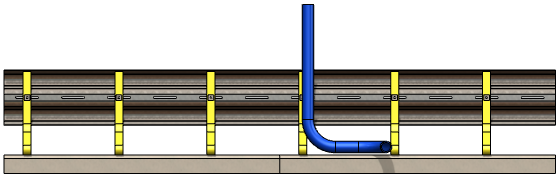

You can vary the linear or angular spacing of individual instances of
linear and circular component patterns to override the pattern spacing.
This example modifies an instance of a linear component pattern by moving a
bracket away from a pipe.
To modify an instance in a pattern:
Open a model that contains a linear component
pattern.
In the FeatureManager design tree, right-click the linear
component pattern and click Edit
Feature
In the PropertyManager, under Instances to Override, click in Modified instances
In
the graphics area, pink selection orbs display on the pattern instances.
Click the selection orb for the instance closest to the pipe
and click Modify Instance.
In the callout, modify the value for Dir 1 offset from nominal to -60mm and click outside of the callout.
A shadow instance appears in the new position.
In the PropertyManager, click
The bracket is no longer behind the pipe.
