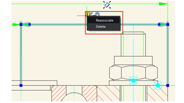

Annotation Monitor (2023 SP1)
Annotation Monitor identifies annotations that are no longer associated with their related geometry.
DraftSight displays the Reassociate and Delete options. You can either reassociate the annotations or delete them.
