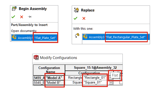

In the Insert Component / Begin Assembly PropertyManager, under
Open documents, the component name includes
the component description. In the Replace
PropertyManager, under With this one, the
component name includes the component description.
In the Modify
Configurations dialog box and the Configuration
Table dialog box, under Configuration
Name and Configuration, the
configuration name includes the configuration description. You can hover over the header
of a parameter column to view the component description.
