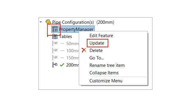

For models that have multiple configurations created with a custom PropertyManager, the PropertyManager icon changes to after you manually add, delete, or rename a configuration. Update appears when you right-click PropertyManager.
To update a multiple-configuration model:
  1. Open a model with multiple configurations created with a custom PropertyManager.
    Use Configuration Publisher to create a custom PropertyManager.
  2. In the ConfigurationManager tab, add a configuration.
    The PropertyManager icon changes to .
  3. Right-click PropertyManager and click Update.
    After clicking Update, the Excel design table opens, updates, and closes. The PropertyManager icon changes to .
