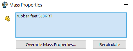

Use the
mass
value specified in the Design
Table |
Enables Override mass or Override center of mass and assigns the manually
entered values to the mass properties. |
Use the
mass
value calculated from the model
geometry |
Deletes the $SW-MASS
column
or the $SW-COG
column that has the manually entered values. The model uses values
calculated from the model geometry. |
