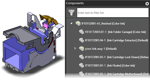

You can display
component properties in the assembly tree of the eDrawings
Components pane.
Component properties
are only available if you published an .EASM file
from SOLIDWORKS with Save file properties for each component
in the assembly selected.
On the Components pane, click Options
and select Show property. This displays the specified property when you open the
Components pane. You can also filter on the
text to find components in a large assembly tree.
