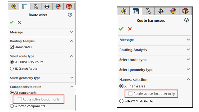

To limit the routing to the top-level assembly
for wires, cables, or harness, do the following:
- In
the Route Wires PropertyManager, under
, select Route active location
only.
- In the Route Cables
PropertyManager, under , select Route active location
only.
- In the Route Harnesses
only.
This capability reduces the overall design time
spent while working on large electrical projects with nested locations. You can limit
the routing process to the active or top location only instead of routing or updating
the sublocations each time you execute the route command on the top-level assembly.
