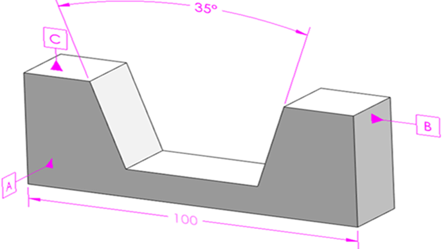

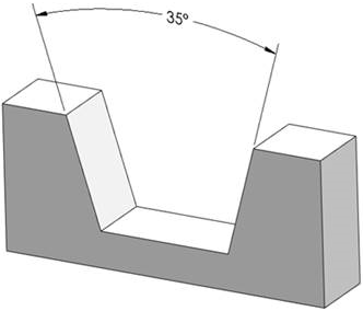

MBD supports wedge features. A wedge has two nonparallel planes with opposing vectors.
To create a wedge:
  1. Click Size Dimension (MBD Dimension toolbar).
  2. Select the first plane.
  3. From the Feature Selector, click Create Width/Wedge Feature .
  4. Select the second plane.
  5. In the Feature Selector, click .
  6. Click to place the dimension.
