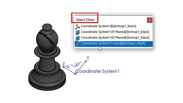

Select
Other
Select coordinate system axes,
planes, and origin. |
