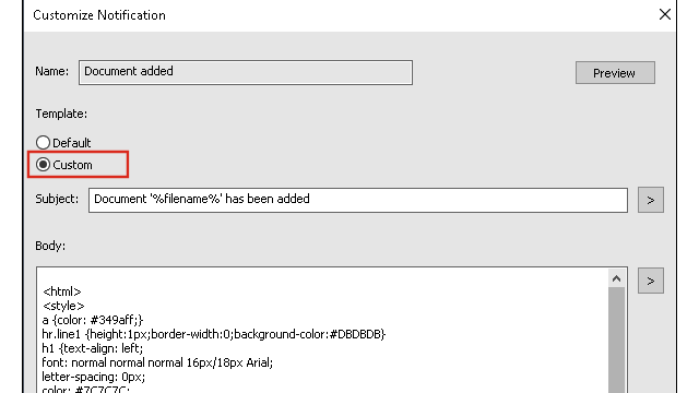

SOLIDWORKS PDM lets administrators customize the templates for automatic notifications for a vault. This helps to display information that is more relevant to the user.

You can edit the subject and body of the template in HTML format and also use variables in the notification message.
