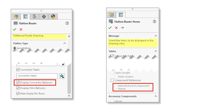

Improvements to the flatten route design deliver higher-quality flatten
route drawings.
Improvements relate to the following items:
- The Auto-Balloon option applies to
balloons for connectors and
wires
- When you modify a connector table, you can apply this change to
all existing connector tables
- The Show/Hide
Flatten
Route
Items
command is available in the Electrical
toolbar
- In the Flatten Route
Items PropertyManager, you can select Manufacturer (component name) to split the text displayed for
the component in the flattened route drawing
