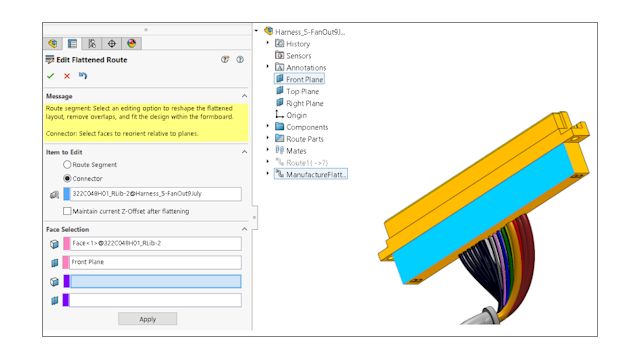

Reorienting Connectors in Flattened Routes
You can reorient the connectors to be parallel to a selected plane.
In the Edit Flattened Route PropertyManager, select a plane in Faces and Planes. This does not affect the Maintain 3D Orientation process.
