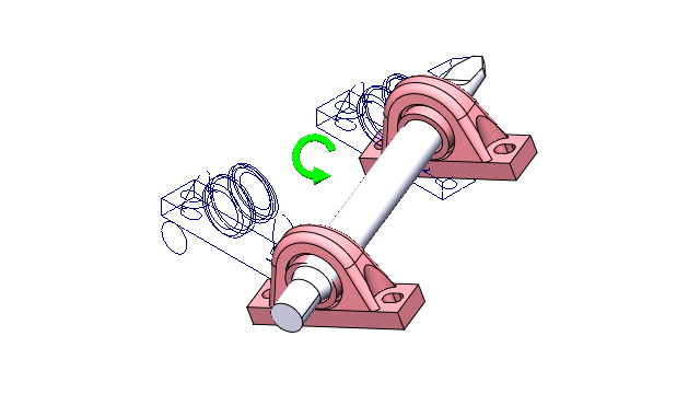

The improved algorithm offers the
following advantages compared to the legacy
Underconstrained
Bodies functionality:
- Faster detection of free body modes because the solver performs
Singular Value Decomposition (SVD) over the reduced stiffness matrix.
- Inclusion of contact interactions and bolt connectors when
analyzing free body modes.
- Realistic visualization of free body modes in planes that are inclined to
the orthogonal planes that are defined by the global X-, Y-, and Z-axes.
- Improved visualization of unconstrained displacements for the
whole assembly.
