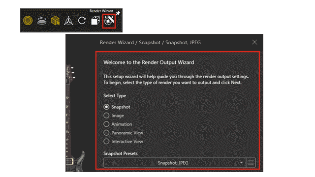

To use the Render Output
Wizard:
- In the main toolbar, click Render
Wizard

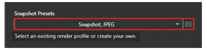

- In the Welcome page, select the render Type and select a render Preset from the list or create a preset using the Smart Control Bar.
- Navigate through the steps presented by the wizard to adjust the
parameters available for the render type.
