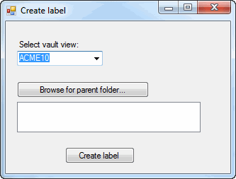

This example shows how to create a label on a folder and all of its subfolders and files.
NOTE: If using the primary interop assembly provided with SOLIDWORKS PDM Professional, see Using .NET Framework 4.0 in Stand-alone Applications.
' Preconditions:
' 1. Start Microsoft Visual Studio.
'    a. Click File > New > Project > Visual Basic > Windows Forms Application.
'    b. Type CreateLabel in Name.
'    c. Click Browse and navigate to the folder where to create
'       the project.
'    d. Click OK
'    e. Click Show All Files in the Solution Explorer toolbar and expand
'       Form1.vb in the Solution Explorer.
'    f. Replace the code in Form1.vb with this code.
'    g. To create the form, replace the code in Form1.Designer.vb with this code.
' 2. Add EPDM.Interop.epdm.dll as a reference (right-click the project
'    name in the Solution Explorer, click Add Reference, click
'    Assemblies > Framework in the left-side panel, browse to the top folder of
'    your SOLIDWORKS PDM Professional installation, locate and click
'    EPDM.Interop.epdm.dll, click Open, click Add, and click Close).
' 3. Right-click EPDM.Interop.epdm in References, click Properties, and set
'    Embed Interop Types to False to handle methods that pass arrays of
'    structures.
' 4. Click Debug > Start Debugging or press F5.
' Postconditions:
' 1. Displays the Create label dialog box.
'    a. Select a vault view.
'    b. Click Browse for parent folder
'       1. Locate and click a folder in the vault.
'       2. Click OK.
'    c. Click Create label.
'       1. Creates label, MyCompany, on the selected folder and all of its
'          subfolders and files.
'       2. Displays a message box with information about all of the labels
'          on the selected folder.
'       3. Click OK.
' 2. Close the Create label dialog box.
' 3. To verify label creation on a folder or file, open a view on the
'    selected vault, click either a folder or a file, and click
'    Display > History.
