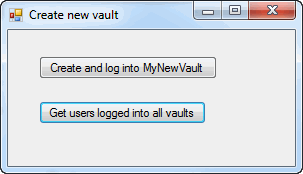

// 1. Displays the Create new vault dialog box.
//    a. Click Create and log in to MyNewVault.
//    b. After a few seconds, displays a login dialog.
//    c. Type Admin's password in Password.
//    d. Click Log in.
//       1. MyNewVault is created using the Default configuration in the root
//          folder of the archive server.
//       2. A view of MyNewVault, accessible to all users, is created in c:\temp.
//       3. Admin is logged into MyNewVault.
//    e. Click Get users logged into all vaults
//    f. Displays a dialog with all of the users currently logged into
//       vault views on this machine.
//    g. Click OK.
// 2. Close the Create new vault dialog box.

            this.GetLoggedIn = new System.Windows.Forms.Button();
            this.Button1 = new System.Windows.Forms.Button();
            this.SuspendLayout();
            //GetLoggedIn
            this.GetLoggedIn.Location = new System.Drawing.Point(31, 71);
            this.GetLoggedIn.Name = "GetLoggedIn";
            this.GetLoggedIn.Size = new System.Drawing.Size(167, 23);
            this.GetLoggedIn.TabIndex = 5;
            this.GetLoggedIn.Text = "Get users logged into all vaults";
            this.GetLoggedIn.UseVisualStyleBackColor = true;
            this.GetLoggedIn.Click +=new System.EventHandler(GetLoggedIn_Click);
            //Button1
            this.Button1.Location = new System.Drawing.Point(31, 26);
            this.Button1.Name = "Button1";
            this.Button1.Size = new System.Drawing.Size(178, 23);
            this.Button1.TabIndex = 6;
            this.Button1.Text = "Create and log in to MyNewVault";
            this.Button1.UseVisualStyleBackColor = true;
            this.Button1.Click +=new System.EventHandler(Button1_Click);
            //Form1
            this.AutoScaleDimensions = new System.Drawing.SizeF(6f, 13f);
            this.AutoScaleMode = System.Windows.Forms.AutoScaleMode.Font;
            this.ClientSize = new System.Drawing.Size(287, 136);
            this.Controls.Add(this.Button1);
            this.Controls.Add(this.GetLoggedIn);
            this.Name = "Form1";
            this.Text = "Create new vault";
            this.Load += new System.EventHandler(this.Form1_Load);
            this.ResumeLayout(false);
            this.PerformLayout();
        #endregion
        internal System.Windows.Forms.Button GetLoggedIn;
        internal System.Windows.Forms.Button Button1;
