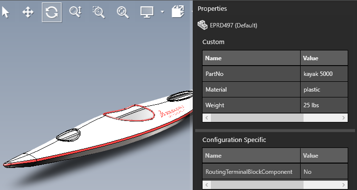

You can
view the custom and configuration-specific properties of SOLIDWORKS files in
eDrawings.
![](orc1624390638190.image)
Configuration-specific data is available for the last-saved
configuration and for configurations where you selected Add Display Data Mark in SOLIDWORKS, for SLDPRT and SLDASM files
only.
To view
properties:
Click or Properties
