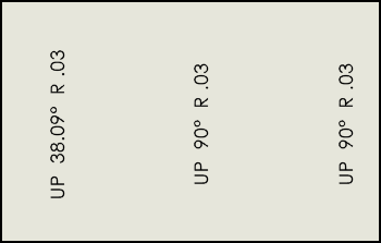

View Bend Lines
Control the visibility of bend lines in flat pattern drawing views of sheet metal parts.
Click one of the following:
  • Hide/Show Items > View Bend Lines
  • View Bend Lines (View toolbar)
  • View > Hide/Show > Sketches
View Bend Lines selected View Bend Lines cleared
