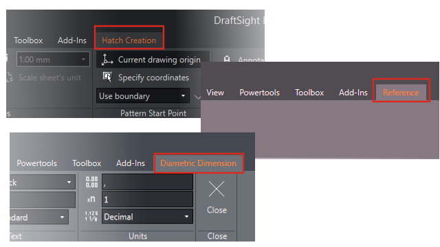

Contextual Ribbon Tabs (2023 SP1)
You can display specific tools on the ribbon when you select particular entities or run the commands to create new entities.
The contextual ribbon tab provides:
  • An uninterrupted view of the graphics area because it is not blocked by the dialog box
  • Immediate visibility of changes that you apply to entities
  • Relevant tools for completing a task
DraftSight offers contextual ribbon tabs for the following operations:
  • Creating and editing hatches
  • Editing table cells
  • Editing PDF and DGN underlays
  • Editing images and external references
  • Editing annotation entities, dimensions, leaders, multileaders, and tolerance symbols.
