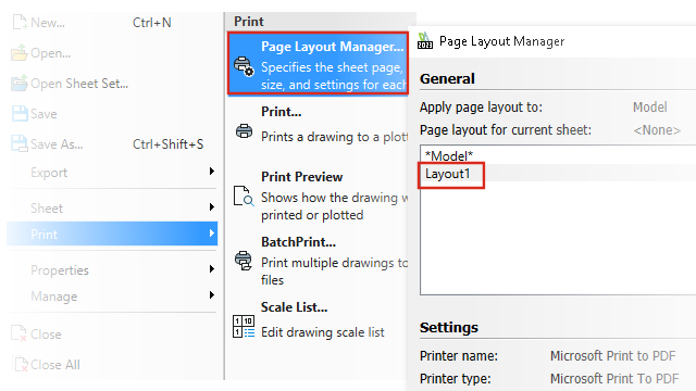

Page Layout Manager (2023 SP1)
You can use Page Layout Manager to save the print settings in a drawing file.
In previous versions, the Print Configuration Manager saved the print settings in the .CFG file. When you shared the drawing file with users, you had to share the .CFG file to retain the print settings.
Under System Options > Printing > General Options, select Use Page Layout Manager.
DraftSight reads and lets you print the print settings of a drawing file created in other software, for example AutoCAD®.
