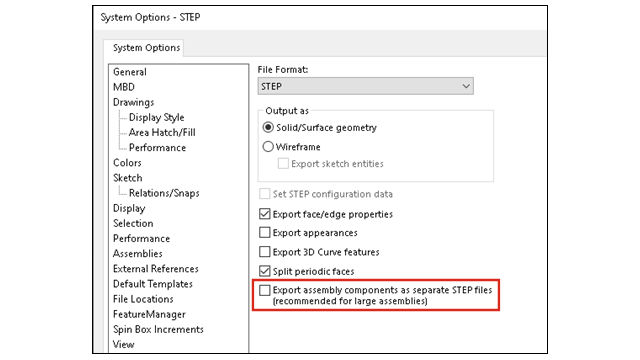

You can export large
SOLIDWORKS®
assemblies as STEP files.
In , select Export assembly components as separate
STEP files (recommended for large assemblies). This option exports
assemblies as atomic STEP files.
Separate STEP
files
get
created for each component in the assembly.
