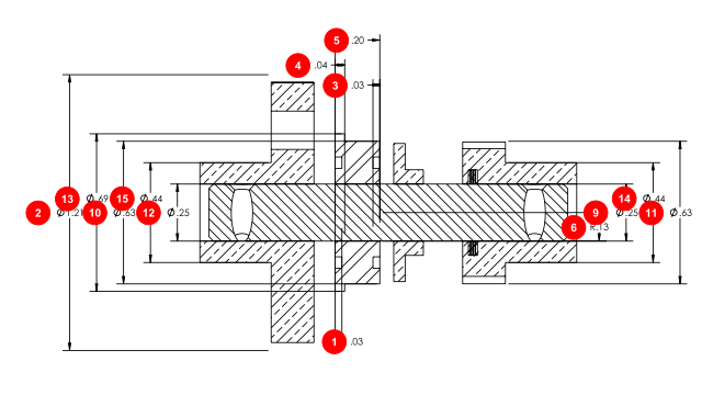

The Auto Extract tool automatically applies balloons to
characteristics in PDF files, which reduces the time
and effort needed to balloon PDF
files.
Auto
Extract uses a machine learning technique to locate the positions and
types of annotations, then attaches balloons to
them. You can also use
this tool to automatically apply balloons to CAD files. The Auto
Extract tool replaces the Smart Extract
tool.
