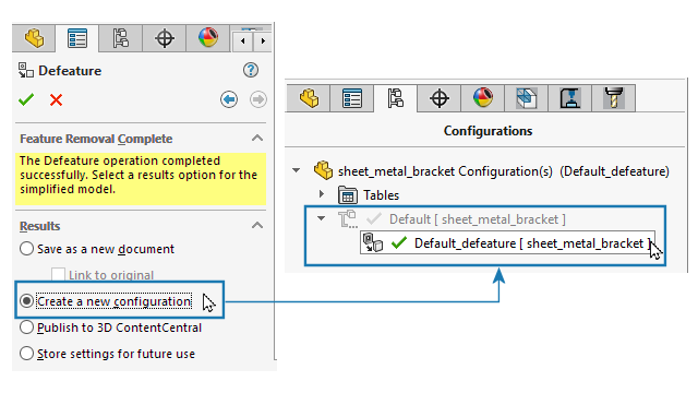

You
can save a defeatured version of a part as a derived configuration.
In the
Defeature PropertyManager, on the Feature Removal
Complete tab, under Results, select
Create a new configuration. You can quickly switch between
the parent configuration and the defeatured configuration. You also have fewer files to
manage. Previously, you could create only a separate external defeatured
file.
