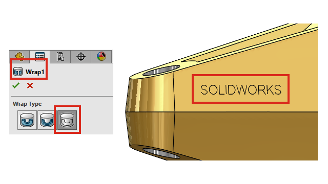

You
can create wrap features from sketches that use single-line fonts when you select
Scribe
for Wrap
Type in the Wrap PropertyManager. Previously, wrap
features did not support single-line fonts.
Single-line fonts are also called stick fonts.
This functionality is particularly helpful for users who want to engrave stick fonts on
parts.
If
text or characters do not display properly, you may be using an inauthentic
single-line font. To check the font, dissolve the sketch text and review the text
entities.
