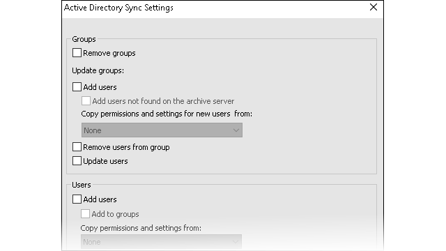

You
can define preferences for sync in the
Active Directory Sync
Settings dialog box. To access this dialog box, right-click the
Users and Groups Management node and select
