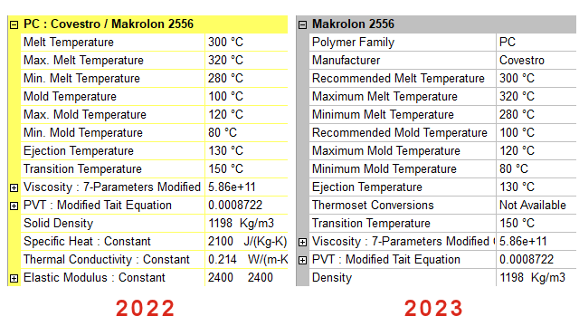

Display enhancements:
  • Gray color border and gray gridlines replace the yellow color border and gridlines to improve the readability of the material properties.
  • The Elastic Modulus, Poisson’s Ratio, and Thermal Expansion Coefficient plots are removed.
  • The material's polymer family and manufacturer name are removed from the title bar and are listed in separate material property fields.

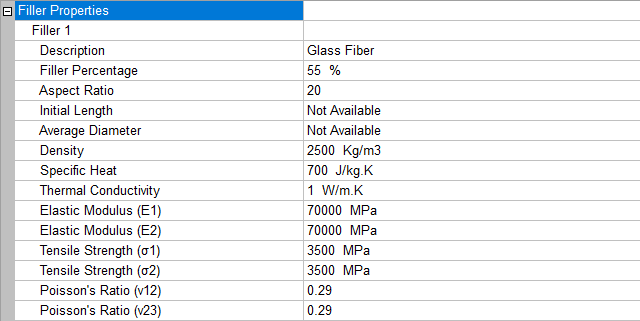

  • The database stores detailed fiber and filler properties for filled materials. You can view these properties under the Filler Properties section.

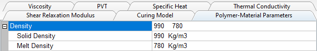

  • In addition to the material's solid density, the database stores its melt density. You can view the material densities under the Density section.
