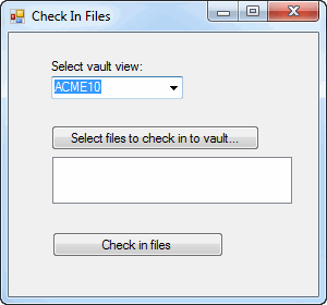

' Postconditions:
'  1. Displays the Check In Files dialog box.
'     a. Select a vault view.
'     b. Click Select files to check out from vault.
'     c. In the Select File dialog:
'        1. Click the checked-out vault file.
'        2. Click Open.
'     d. Click Check in files.
'     e. Displays the Check in dialog box with the Reload or Close Files
'        after Check In
dropdown in the toolbar.
'     f. Click the Check in button.
'     g. Click OK in the message box.
'  2. Close the Check In Files dialog box.
'  3. Observe that the selected file is checked in to the selected vault.

        'Form1
        Me.AutoScaleDimensions = New System.Drawing.SizeF(6.0!, 13.0!)
        Me.AutoScaleMode = System.Windows.Forms.AutoScaleMode.Font
        Me.ClientSize = New System.Drawing.Size(284, 242)
        Me.Controls.Add(Me.BatchUnlock)
        Me.Controls.Add(Me.File1List)
        Me.Controls.Add(Me.SelectFiles)
        Me.Controls.Add(Me.VaultsComboBox)
        Me.Controls.Add(Me.VaultsLabel)
        Me.Name = "Form1"
        Me.Text = "Check In Files"
        Me.ResumeLayout(False)
        Me.PerformLayout()
