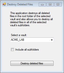

// Postconditions:
//  1. Displays the Destroy Deleted Files dialog.
//  2. Select a vault.
//  3. Optionally select the Include all subfolders check box.
//  4. Click the Destroy deleted files button.
//     A message box pops up informing you that:
//     * No deleted files were found to destroy.
//       - or -
//     * The deleted files were destroyed.
//  5. Click OK in the message box.
//  6. Close the Destroy Deleted Files dialog.

            this.label1.Text = "This application destroys all deleted files in the root folder of the selected va" +
            "ult and also allows you to destroy all deleted files in all of the selected vaul" +
            "t\'s subfolders.";

            this.Text = "Destroy Deleted Files";
