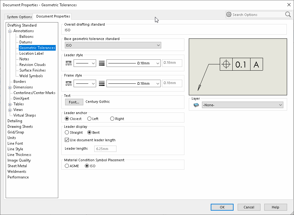

Setting |
Get/Set Methods |
Return Value or <Value> |
Comments |
Base geometric tolerance standard |
IModelDocExtension::GetUserPreferenceInteger(swUserPreferenceIntegerValue_e.swDetailingDimensionStandard,
swUserPreferenceOption_e.swDetailingGeometricTolerance)
IModelDocExtension::SetUserPreferenceInteger(swUserPreferenceIntegerValue_e.swDetailingDimensionStandard,
swUserPreferenceOption_e.swDetailingGeometricTolerance, swDetailingStandard_e.<Value>) |
See swDetailingStandard_e
for valid options |
Specifies the geometric tolerance standard to use |
Leader style - Leader Style |
IModelDocExtension::GetUserPreferenceInteger(swUserPreferenceIntegerValue_e.swDetailingGtolLeaderLineStyle,
swUserPreferenceOption_e.swDetailingNoOptionSpecified)
IModelDocExtension::SetUserPreferenceInteger(swUserPreferenceIntegerValue_e.swDetailingGtolLeaderLineStyle,
swUserPreferenceOption_e.swDetailingNoOptionSpecified, swLineStyles_e.<Value>) |
See swLineStyles_e
for valid options |
Leader style - Leader Thickness |
IModelDocExtension::GetUserPreferenceInteger(swUserPreferenceIntegerValue_e.swDetailingGtolLeaderLineThickness,
IModelDocExtension::SetUserPreferenceInteger(swUserPreferenceIntegerValue_e.swDetailingGtolLeaderLineThickness,
swUserPreferenceOption_e.swDetailingNoOptionSpecified, swLineWeights_e.<Value>) |
See swLineWeights_e
for valid options |
Leader style - Custom thickness |
IModelDocExtension::GetUserPreferenceDouble(swUserPreferenceDoubleValue_e.swDetailingGtolLeaderLineThicknessCustom,
IModelDocExtension::SetUserPreferenceDouble(swUserPreferenceDoubleValue_e.swDetailingGtolLeaderLineThicknessCustom,
swUserPreferenceOption_e.swDetailingNoOptionSpecified, <Value>) |
Double value |
Specifies custom thickness of GTol leader lines; sets Custom Thickness
to the specified thickness and
Leader Thickness to Custom Size |
Frame style - Frame Style |
IModelDocExtension::GetUserPreferenceInteger(swUserPreferenceIntegerValue_e.swDetailingGtolFrameLineStyle,
IModelDocExtension::SetUserPreferenceInteger(swUserPreferenceIntegerValue_e.swDetailingGtolFrameLineStyle,
.<Value>) |
See swLineStyles_e
for valid options |
Frame style - Frame
Thickness |
IModelDocExtension::GetUserPreferenceInteger(swUserPreferenceIntegerValue_e.swDetailingGtolFrameLineThickness,
IModelDocExtension::SetUserPreferenceInteger(swUserPreferenceIntegerValue_e.swDetailingGtolFrameLineThickness,
See swLineWeights_e
for valid options |
Frame style - custom thickness |
IModelDocExtension::GetUserPreferenceDouble(swUserPreferenceDoubleValue_e.swDetailingGtolFrameLineThicknessCustom,
IModelDocExtension::SetUserPreferenceDouble(swUserPreferenceDoubleValue_e.swDetailingGtolFrameLineThicknessCustom,
Double value |
Specifies custom thickness of GTol frame lines; sets Custom Thickness
Text - Font... |
IModelDocExtension::GetUserPreferenceTextFormat(swUserPreferenceTextFormat_e.swDetailingGeometricToleranceTextFormat,
IModelDocExtension::SetUserPreferenceTextFormat(swUserPreferenceTextFormat_e.swDetailingGeometricToleranceTextFormat,
See ITextFormat
for font options |
To set font property values, implement ITextFormat, set the appropriate
ITextFormat member values, and pass the ITextFormat object in the API
set method |
Leader anchor - Closest, Left, or Right |
IModelDocExtension::GetUserPreferenceInteger(swUserPreferenceIntegerValue_e.swDetailingGtolLeaderSide,
IModelDocExtension::SetUserPreferenceInteger(swUserPreferenceIntegerValue_e.swDetailingGtolLeaderSide,
swUserPreferenceOption_e.swDetailingNoOptionSpecified, swLeaderSide_e.<Value>) |
See swLeaderSide_e
for valid options |
Leader display - Straight or Bent |
IModelDocExtension::GetUserPreferenceInteger(swUserPreferenceIntegerValue_e.swDetailingGtolLeaderStyle,
IModelDocExtension::SetUserPreferenceInteger(swUserPreferenceIntegerValue_e.swDetailingGtolLeaderStyle,
swUserPreferenceOption_e.swDetailingNoOptionSpecified, swLeaderStyle_e.<Value>) |
See swLeaderStyle_e
for valid options |
Leader display - Use document leader length |
IModelDocExtension::GetUserPreferenceToggle(swUserPreferenceToggle_e.swDetailingGtolUseDocBentLeaderLength,
IModelDocExtension::SetUserPreferenceToggle(swUserPreferenceToggle_e.swDetailingGtolUseDocBentLeaderLength,
Boolean value |
Specifies whether to use document bent leader lengths for geometric
tolerance annotations |
Leader display - Leader length |
IModelDocExtension::GetUserPreferenceDouble(swUserPreferenceDoubleValue_e.swDetailingGtolBentLeaderLength,
IModelDocExtension::SetUserPreferenceDouble(swUserPreferenceDoubleValue_e.swDetailingGtolBentLeaderLength,
Double value |
Specifies the length of GTol bent leaders in a drawing document |
Material Condition Symbol Placement - ASME or ISO |
IModelDocExtension::GetUserPreferenceInteger(swUserPreferenceIntegerValue_e.swDetailingGtolMaterialConditionSymbolPlacement,
IModelDocExtension::SetUserPreferenceInteger(swUserPreferenceIntegerValue_e.swDetailingGtolMaterialConditionSymbolPlacement,
swDetailingGtolMaterialConditionSymbolPlacement_e.<Value>) |
See
for valid options |
Layer |
IModelDocExtension::GetUserPreferenceString(swUserPreferenceStringValue_e.swDetailingLayer,
swuserPreferenceOption_e.swDetailingGeometricTolerance)
IModelDocExtension::SetUserPreferenceString(swUserPreferenceStringValue_e.swDetailingLayer,
swuserPreferenceOption_e.swDetailingGeometricTolerance, <Value>) |
String value |
Specifies the name of the layer to apply settings to; this setting is
available only on drawings |
