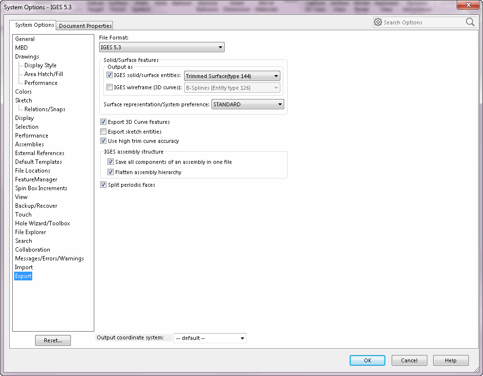

System Options > Export > IGES 5.3
This topic contains two tables. The information in the table:
  • appearing immediately after the screen capture corresponds to the settings on that dialog.
  • titled Obsolete Enumerators contains enumerators that previously appeared on the dialog but are now obsolete.
To display the dialog:
Click Tools > Options > System Options > Export > IGES 5.3 in File Format.
- or -
  1. Click File > Save As.
  2. In Save as type, select IGES.
  3. Click Options.
Setting
Get/Set Methods
Return Value
or
<Value>
or
<OnFlag>
Comment
Solid/Surface features - Output as - IGES solid/surface entities
ISldWorks::GetUserPreferenceToggle(swUserPreferenceToggle_e.swIGESExportSolidAndSurface)
ISldWorks::SetUserPreferenceToggle(swUserPreferenceToggle_e.swIGESExportSolidAndSurface, <OnFlag>)
Boolean value
Specifies whether to export data as solid or surface entities
Solid/Surface features - Output as - IGES solid/surface entities <value>
ISldWorks::GetUserPreferenceIntegerValue(swUserPreferenceIntegerValue_e.swIGESRepresentation)
ISldWorks::SetUserPreferenceIntegerValue(swUserPreferenceIntegerValue_e.swIGESRepresentation, swIGESRepresentation_e.<Value>)
See swIGESRepresentation_e for valid options
Specifies IGES representation type
Solid/Surface features - Output as - IGES wireframe (3D curves)
ISldWorks::GetUserPreferenceToggle(swUserPreferenceToggle_e.swIGESExportAsWireframe)
ISldWorks::SetUserPreferenceToggle(swUserPreferenceToggle_e.swIGESExportAsWireframe, <OnFlag>)
Boolean value
Specifies whether to convert solid body to a 3D wireframe representation in the IGES file
Solid/Surface features - Output as - IGES wireframe (3D curves) <value>
ISldWorks::GetUserPreferenceIntegerValue(swUserPreferenceIntegerValue_e.swIGESCurveRepresentation)
ISldWorks::SetUserPreferenceIntegerValue(swUserPreferenceIntegerValue_e.swIGESCurveRepresentation, swIGESCurveRepresentation_e.<Value>)
See swIGESCurveRepresentation_e for valid options
Specifies the IGES curve representation
Solid/Surface features - Surface representation/System preference
ISldWorks::GetUserPreferenceIntegerValue(swUserPreferenceIntegerValue_e.swIGESSystem)
ISldWorks::SetUserPreferenceIntegerValue(swUserPreferenceIntegerValue_e.swIGESSystem, swIGESPreferredSystem_e.<Value>)
See swIGESPreferredSystem_e for valid options
Specifies the IGES system setting
Export 3D Curve features
ISldWorks::GetUserPreferenceToggle(swUserPreferenceToggle_e.swIGESExportFreeCurves)
ISldWorks::SetUserPreferenceToggle(swUserPreferenceToggle_e.swIGESExportFreeCurves, <OnFlag>)
Boolean value
Specifies whether to include 3D curve features in the exported file
Export sketch entities
ISldWorks::GetUserPreferenceToggle(swUserPreferenceToggle_e.swIGESExportSketchEntities)
ISldWorks::SetUserPreferenceToggle(swUserPreferenceToggle_e.swIGESExportSketchEntities, <OnFlag>)
Boolean value
Specifies whether to export sketch entities
Use high trim curve accuracy
ISldWorks::GetUserPreferenceToggle(swUserPreferenceToggle_e.swIGESHighTrimCurveAccuracy)
ISldWorks::SetUserPreferenceToggle(swUserPreferenceToggle_e.swIGESHighTrimCurveAccuracy, <OnFlag>)
Boolean value
Specifies whether to use high-trim curve accuracy
IGES assembly structure - Save all components of an assembly in one file
ISldWorks::GetUserPreferenceToggle(swUserPreferenceToggle_e.swIGESComponentsIntoOneFile)
ISldWorks::SetUserPreferenceToggle(swUserPreferenceToggle_e.swIGESComponentsIntoOneFile, <OnFlag>)
Boolean value
Specifies whether to save all assembly components, sub-assemblies, and sub-assembly components in one file; for assemblies only
IGES assembly structure - Flatten assembly hierarchy
ISldWorks::GetUserPreferenceToggle(swUserPreferenceToggle_e.swIGESFlattenAssemHierarchy)
ISldWorks::SetUserPreferenceToggle(swUserPreferenceToggle_e.swIGESFlattenAssemHierarchy, <OnFlag>)
Boolean value
Specifies whether to save assembly in flattened hierarchy (one level); for assemblies only
Split periodic faces
ISldWorks::GetUserPreferenceToggle(swUserPreferenceToggle_e.swIGESExportSplitPeriodic)
ISldWorks::SetUserPreferenceToggle(swUserPreferenceToggle_e.swIGESExportSplitPeriodic, <OnFlag>)
Boolean value
Specifies whether to split periodic faces; for parts only
Output coordinate system
ISldWorks::GetUserPreferenceStringValue(swUserPreferenceStringValue_e.swExportOutputCoordinateSystem)
ISldWorks::SetUserPreferenceStringValue(swUserPreferenceStringValue_e.swExportOutputCoordinateSystem, <Value>)
String value
