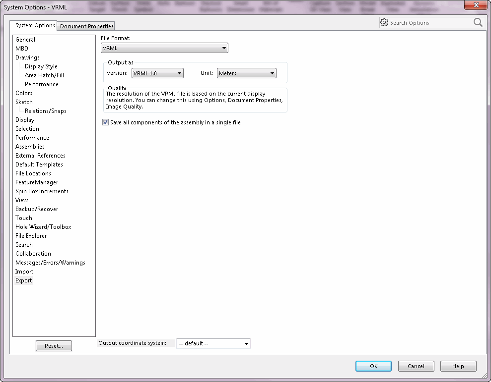

System Options > Export > VRML
This topic contains two tables. The information in the table:
  • appearing immediately after the screen capture corresponds to the settings on that dialog.
  • titled Obsolete Enumerators contains enumerators that previously appeared on the dialog but are now obsolete.
To display the dialog:
Click Tools > Options > System Options > Export > VRML in File Format.
- or -
  1. Click File > Save As.
  2. In Save as type, select VRML.
  3. Click Options.

Output as - Version
ISldWorks::GetUserPreferenceIntegerValue(swUserPreferenceIntegerValue_e.swExportVrmlVersion)
ISldWorks::SetUserPreferenceIntegerValue(swUserPreferenceIntegerValue_e.swExportVrmlVersion, swVrmlOutputVersion_e.<Value>)
Values as defined in swVrmlOutputVersion_e
Output as - Unit
ISldWorks::GetUserPreferenceIntegerValue(swUserPreferenceIntegerValue_e.swExportVrmlUnits)
ISldWorks::SetUserPreferenceIntegerValue(swUserPreferenceIntegerValue_e.swExportVrmlUnits, swLengthUnit_e.<Value>)
Any of the following swLengthUnit_e values:
  • 0 = swMM (millimeters)
  • 1 = swCM (centimeters)
  • 2 = swMETER
  • 3 = swINCHES
  • 4 = swFEET
Save all components of the assembly in a single file
ISldWorks::GetUserPreferenceToggle(swUserPreferenceToggle_e.swExportVrmlAllComponentsInSingleFile)
ISldWorks::SetUserPreferenceToggle(swUserPreferenceToggle_e.swExportVrmlAllComponentsInSingleFile, <OnFlag>)
Boolean value
Specifies whether to save all of the components of an assembly to a single VRML (.wrl) file
Output coordinate system
ISldWorks::GetUserPreferenceStringValue(swUserPreferenceStringValue_e.swExportOutputCoordinateSystem)
ISldWorks::SetUserPreferenceStringValue(swUserPreferenceStringValue_e.swExportOutputCoordinateSystem, <Value>)
String value
