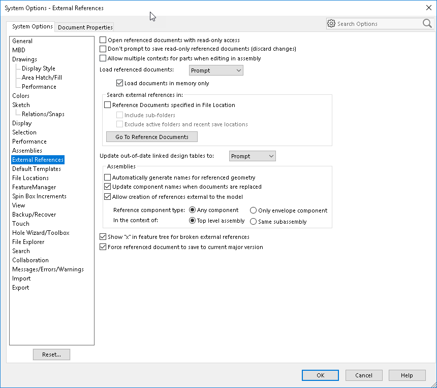

System Options > External References
This topic contains two tables. The information in the table:
  • appearing immediately after the screen capture of the dialog corresponds to the settings on that dialog.
  • titled Obsolete Enumerators contains enumerators that previously appeared on the dialog but are now obsolete.
Setting
Get/Set Methods
Return Value
or
<Value>
or
<OnFlag>
Comment
Open referenced documents with read-only access
(Not supported in SOLIDWORKS Connected)
ISldWorks::GetUserPreferenceToggle(swUserPreferenceToggle_e.swExtRefOpenReadOnly)
ISldWorks::SetUserPreferenceToggle(swUserPreferenceToggle_e.swExtRefOpenReadOnly, <OnFlag>)
Boolean value
Specifies whether to open referenced documents as read-only
Don't prompt to save read-only referenced documents (discard changes)
ISldWorks::GetUserPreferenceToggle(swUserPreferenceToggle_e.swExtRefNoPromptOrSave)
ISldWorks::SetUserPreferenceToggle(swUserPreferenceToggle_e.swExtRefNoPromptOrSave, <OnFlag>)
Boolean value
Specifies whether to close read-only reference documents without prompting or attempting to save changes made to them when saving or closing the parent document
Allow multiple contexts for parts when editing in assembly
ISldWorks::GetUserPreferenceToggle(swUserPreferenceToggle_e.swExtRefMultipleContexts)
ISldWorks::SetUserPreferenceToggle(swUserPreferenceToggle_e.swExtRefMultipleContexts, <OnFlag>)
Boolean value
Specifies whether to create external references to a single part from more than one assembly context
Load referenced documents
ISldWorks::GetUserPreferenceIntegerValue(swUserPreferenceIntegerValue_e.swLoadExternalReferences)
ISldWorks::SetUserPreferenceIntegerValue(swUserPreferenceIntegerValue_e.swLoadExternalReferences, swLoadExternalReferences_e.<Value>)
See swLoadExternalReferences_e for valid options
Note: If this setting is swLoadExternalReferences_e.swLoadExternalReferences_None, then IDocumentSpecification::LoadExternalReferencesInMemory is not observed
Load documents in memory only
ISldWorks::GetUserPreferenceToggle(swUserPreferenceToggle_e.swExtRefLoadRefDocsInMemory)
ISldWorks::SetUserPreferenceToggle(swUserPreferenceToggle_e.swExtRefLoadRefDocsInMemory, <OnFlag>)
Boolean value
Specifies whether to load reference documents in memory only
This setting (whether in the user interface or through the API) is ignored when opening documents through the API because IDocumentSpecification::LoadExternalReferencesInMemory and ISldWorks::OpenDoc6 (swOpenDocOptions_e.swOpenDocOptions_LoadExternalReferencesInMemory) have sole control over reference loading
Search external references in - Reference Documents specified in File Location
ISldWorks::GetUserPreferenceToggle(swUserPreferenceToggle_e.swUseFolderSearchRules)
ISldWorks::SetUserPreferenceToggle(swUserPreferenceToggle_e.swUseFolderSearchRules, <OnFlag>)
Boolean value
Specifies whether to search the Referenced Documents list of folders in the File Locations Options dialog
Search external references in - Reference Documents specified in File Location - Include sub-folders
ISldWorks::GetUserPreferenceToggle(swUserPreferenceToggle_e.swExtRefIncludeSubFolders)
ISldWorks::SetUserPreferenceToggle(swUserPreferenceToggle_e.swExtRefIncludeSubFolders, <OnFlag>)
Boolean value
Specifies whether to search for reference documents in sub-folders in the specified file location; valid only if Reference Documents specified in File Location is true
Search external references in - Reference Documents specified in File Location - Exclude active folders and recent save locations
ISldWorks::GetUserPreferenceToggle(swUserPreferenceToggle_e.swExtRefExcludeActiveFoldersAndRecentSaveLocations)
ISldWorks::SetUserPreferenceToggle(swUserPreferenceToggle_e.swExtRefExcludeActiveFoldersAndRecentSaveLocations, <OnFlag>)
Boolean value
Specifies whether to block searching for reference documents in open folders and folders containing recently saved items; valid only if Reference Documents specified in File Location is true
Update out-of-date linked design tables to
ISldWorks::GetUserPreferenceIntegerValue(swUserPreferenceIntegerValue_e.swExternalReferencesUpdateOutOfDateLinkedDesignTable)
ISldWorks::SetUserPreferenceIntegerValue(swUserPreferenceIntegerValue_e.swExternalReferencesUpdateOutOfDateLinkedDesignTable, swExternalReferencesUpdateOutOfDateLinkedDesignTable_e.<Value>)
See swExternalReferencesUpdateOutOfDateLinkedDesignTable_e for valid options
Assemblies - Automatically generate names for referenced geometry
ISldWorks::GetUserPreferenceToggle(swUserPreferenceToggle_e.swExtRefAutoGenNames)
ISldWorks::SetUserPreferenceToggle(swUserPreferenceToggle_e.swExtRefAutoGenNames, <OnFlag>)
Boolean value
Specifies whether to automatically generate names for referenced geometry
Assemblies - Update component names when documents are replaced
ISldWorks::GetUserPreferenceToggle(swUserPreferenceToggle_e.swExtRefUpdateCompNames)
ISldWorks::SetUserPreferenceToggle(swUserPreferenceToggle_e.swExtRefUpdateCompNames, <OnFlag>)
Boolean value
Specifies whether to mate to read-only parts using internal face IDs of the parts or to replace components using surface identifiers to write-access parts
Assemblies - Allow creation of  references external to the model
ISldWorks::GetUserPreferenceToggle(swUserPreferenceToggle_e.swAllowCreationOfReferencesExternalToModel)
ISldWorks::SetUserPreferenceToggle(swUserPreferenceToggle_e.swAllowCreationOfReferencesExternalToModel, <OnFlag>)
Boolean value
Specifies whether to permit creation of external references when designing in the context of an assembly
Assemblies - Allow creation of  references external to the model - Reference component type:
ISldWorks::GetUserPreferenceToggle(swUserPreferenceToggle_e.swReferenceOnlyEnvelopeComponentType)
ISldWorks::SetUserPreferenceToggle(swUserPreferenceToggle_e.swReferenceOnlyEnvelopeComponentType, <OnFlag>)
Boolean value
True if only envelope component, false if any component
Assemblies - Allow creation of  references external to the model - In the context of:
ISldWorks::GetUserPreferenceToggle(swUserPreferenceToggle_e.swReferenceInContextOfTopLevelAssembly)
ISldWorks::SetUserPreferenceToggle(swUserPreferenceToggle_e.swReferenceInContextOfTopLevelAssembly, <OnFlag>)
Boolean value
True if in context of top level assembly, false if in context of same subassembly
Show "x" in feature tree for broken external references
ISldWorks::GetUserPreferenceToggle(swUserPreferenceToggle_e.swExtRefShowXInFeatureTree)
ISldWorks::SetUserPreferenceToggle(swUserPreferenceToggle_e.swExtRefShowXInFeatureTree, <OnFlag>)
Boolean value
Specifies whether to hide or show the x that appears in the FeatureManager design tree to indicate broken references
Force referenced document to save to current major version
ISldWorks::GetUserPreferenceToggle(swUserPreferenceToggle_e.swExtRefForceSaveToCurrentVersion)
ISldWorks::SetUserPreferenceToggle(swUserPreferenceToggle_e.swExtRefForceSaveToCurrentVersion, <OnFlag>)
Boolean value
