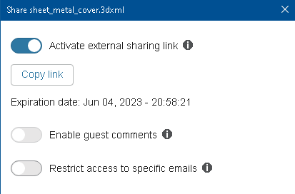

In the dialog box, do one of the following:
- Click Close to exit the dialog box. The file
successfully uploads to 3DDrive but is not yet shared.
- Enable the Activate external share link option to
continue with sharing the file.
When you activate external sharing, specify these options in the dialog
box:
- Copy link. Copies the link to the clipboard for
you to share with others.
- Enable guest comments. Lets others mark
up or make comments
about
the design in 3DDrive.
- Restrict access to specific users.
Restricts
access to only those you specify by email in the
Enter an email field
below.
- Add a message. Lets you add a
message
included
in the email notification sent to all the listed
emails.
- Show in 3DDrive. Opens 3DDrive in
the Task
Pane.
Click Share.
