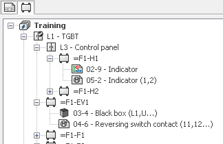

Components are listed in a specific tab on the dockable panel. When you double-click a symbol of a component, it opens the drawing in which the symbol is inserted.

You can use the [F5] key or the Refresh command, in the context menu of the electrical project, to refresh the component list. From the context menu of the electrical project, click the View submenu to view the different modes of the component list.
Option Description
Location view/ Function view This mode allows you to display the components grouped by location or by function.
Child components by hierarchy / Child components in real location (function) This option allows you to display a child component under its parent, or under its real location (function) when the location (function) of the child component is different from that its parent.
Sort by function (location) / Sort by mark Allows you to sort the components by the mark or by the location (function).
In terminal strip and PLC, sort by position / Always sort by mark This option impacts only PLC and terminal strips. It allows you to sort the subcomponents of a terminal strip or a PLC, by the mark or the position.
Hide accessory terminals Allows you to hide the accessories terminals.
