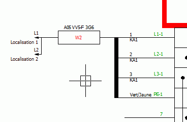

Wires and Cable Cores
The lower part of the dialog box lets you manage the text parameters
(for example, font, size, or display) as well as the text's position on the line
representing the wire or cable core connected to the terminal. In the upper part of
the display, red dots (visible when you select a parameter for offset in X or Y)
mark the default text insertion point (offsets in X and Y equal to 0).
Name |
Description |
General |
A Wire length |
Lets you specify the length A
of the line representing a wire. |
B Cable core length |
Lets you specify the length B
of the line representing a cable core. |
Options |
Visualize terminal pins |
Select this option if you want to show the terminal
pins like in the terminal strip editor. |
Line color |
Lets you select the color of the line representing the
terminal pins. |
Cable core length |
Select this option to group all the cable cores
connected on one terminal and connect only one cable core to the
terminal. |
C Distance to connection
point |
Lets you enter the distance between the terminal and
the line allowing to group the cable cores. |

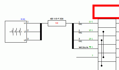

Bridges
Name |
Description |
General |
A Dot diameter |
Lets you specify the diameter A
of the dots representing the bridge connection on the terminal. |
B Bridge offset |
Lets you specify the distance B
between two lines representing a bridge. This adds the parameter to the
Distance before bridge parameter. |
C Distance before
bridge |
Lets you specify the distance C
between the terminal axis (middle) and the line representing the
bridge. |
Color |
Lets you specify the color to draw the bridges (point
and line). |
Automatic bridges |
Color |
Lets you specify the color to draw the automatic
bridges (point and line). |
Show wire |
Shows or hides the wire connected on the terminal when
you link it with another. |
Cable
A customizable basic symbol (Cable label) represents the cable in the terminal strip
drawing.
The first two zones of the lower part of the dialog box display the text parameters
(such as the font, the color, or the size) as well as their positioning parameters.
Text centers on the intersection point of the rectangle's two diagonals. The X
offset and Y offset parameters allow you to control the distance between the text
and this point
The third zone of the lower part (Cable label) lets you select a
symbol that is positioned on the base point (the intersection of the rectangle's two
diagonals). Three icons are available to Add
a new symbol, Remove the symbol displayed,
and Edit the symbol displayed.
This symbol is added to the basic symbol. To display your own
symbol, hide the basic symbol by setting its dimensions to 0 and hiding its
text.

Destination
This tab lets you manage the display of cable destinations. These destinations can be
represented in the form of a symbol. If you opt not to represent the cable
destinations in the form of a symbol, it displays only the mark and location
name.
Name |
Description |
General |
Detail cables destination |
When selected, the drawing represents these destinations by placing
one or more symbols within a rectangle. The drawing displays the
detail of the cable cores as well as the material terminals of the
component.
When cleared, it displays only the mark and location name.
The availability of the following options depends on the state of
this option.
Destination symbol type |
Specify the type of symbol (Line diagram or Schema) you want to insert.
Options are possible if SOLIDWORKS Electrical does not find symbols of
the requested type. |
A Destination cable core
length |
Defines the length A of the
line, symbolizing the cable core on the destination side. |
B Length of the rectangle
containing the destination symbol |
Defines the length B of the
side of the rectangle framing the symbol. |
Symbol centering margin in percent |
Defines the margin between the symbol and its contour,
and assigns a scale factor to the symbol according to its size. |
A Offset for next
destination |
Defines the offset distance A
when there is a change of location in the cable destination
point. |
